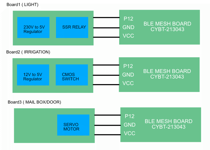

Total 4 boards i have used with below applications :

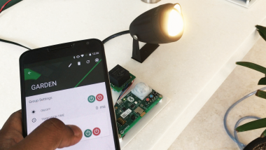

1. LIGHT control with PIR and Light Sense
2. Irrigation for Plants
3. Door security and control
4. Remote control with CAR Keys.
(1) and (2) are sight forward , I used Ambient sensors and PIR Sensing values to provide intelligent on controlling lights , The light can turn ON/OFF from mesh controller app. PIR mode will be active only if the lights is OFF. Which means if the light is turned ON by PIR sense mode , after a timeout it will go OFF automatically.
(2) I used 12v DC pump which is good to showcase irrigation for small pot plants. with the help of Analog switches i able to control this pump.
(3) To showcase the door access demo, i had to use the setup which uses servo motor to open and close. I created PWM signals and control over through the mesh network.
(4) Just a remote , to control the anyof above applications , the concept is, in future all car keys will have BLE's so once you reached your house near. The Car key will connect to the home mesh network and you can control entry gate, garage doors or mail boxs etc.
Android App:
In android app side , i could not do much changes due to time limitation and code complexity , I changed colors and some icons.
Important thing is i added internet facility to the mesh app, through that we can send whats-app notification to the our mobile with the help of twilio interface.

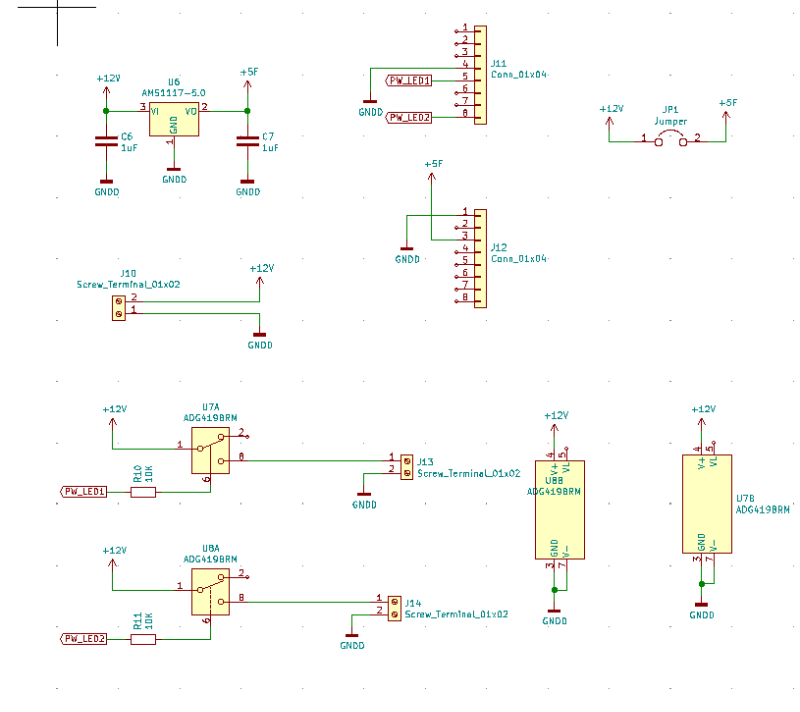

Schematics and circuit diagrams
Schematic2
Add on boards
Schematic Blocks
Overview and PIN details
